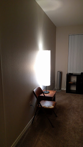

G+_Steven Traversino Posted September 2, 2016 Share Posted September 2, 2016 I took a 2 meter strip of 144 led/m ws2812 and wrapped it around the base of a cheap Ikea paper lamp. I'm using a pi zero as the brains with the hyperion app. It's bright enough to make the room visible at night. I have two other lamps with a similar setup but 2.5 meters and 60 leds/meter. They aren't that bright, but work well enough for mood lighting. The more leds you pack into the space will produce sufficient light, just need something to diffuse it so it's not as harsh. Link to comment Share on other sites More sharing options...
