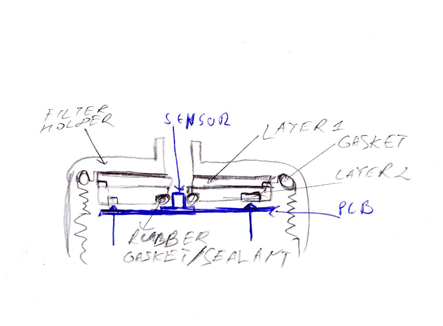

G+_Edvardas Rimkus Posted May 24, 2017 Share Posted May 24, 2017 Hi KITA’s, for a project I need to attach some pcb’s to an inside of a filter container, a part of pcb components need to be exposed to water outside of filter. I was thinking about 3d printing a two-piece interface disc, with hidden nuts inside. I was thinking about using Tinker cad for design. The main question is to use PLA or ABS? because it will in be submerged water up to 4 meters for long periods of time. Link to comment Share on other sites More sharing options...

G+_Edvardas Rimkus Posted May 24, 2017 Author Share Posted May 24, 2017 I would still need to make a hole in the pelican case. Maybe more background about the project would help. This project will be a submerged wave logger, and the hole in top of holder will go directly to pressure sensor Link to comment Share on other sites More sharing options...

G+_Edvardas Rimkus Posted May 24, 2017 Author Share Posted May 24, 2017 Yes it will be anchored, to a side and bottom of a river. The device is based on OWHL (http://lukemiller.org/index.php/2014/08/open-wave-height-logger/) project by Luke Miller. The external body is a RO membrane filter holder :) (https://www.senukai.lt/p/korpusas-ro-sistemos-membranai-vagner-sdh/4040). the bottom holes will be used for mounting hardware, the top hole will be open to the pressure sensor. The printed part will just connect the pcb to the top screw in part. It will be powered by 3 D cells. The electronics are complete, and dry tested. electronics and battery pack fits inside the holder with a decent amount of space left. senukai.lt - Korpusas RO sistemos membranai „Vagner SDH“ - Senukai.lt Link to comment Share on other sites More sharing options...
G+_Black Merc Posted May 24, 2017 Share Posted May 24, 2017 If i had just those two options, I'd go abs. Pla is said to be biodegradable. I'd prefer pvc or polycarb. Link to comment Share on other sites More sharing options...
G+_Darrell Sullivan Posted May 25, 2017 Share Posted May 25, 2017 I would go with ABS here. You can treat it with acetone and that should help turn the external layers into a more unified shell. I would probably still coat the structure with some sort of silicone or something to help make it water resistant. Link to comment Share on other sites More sharing options...
