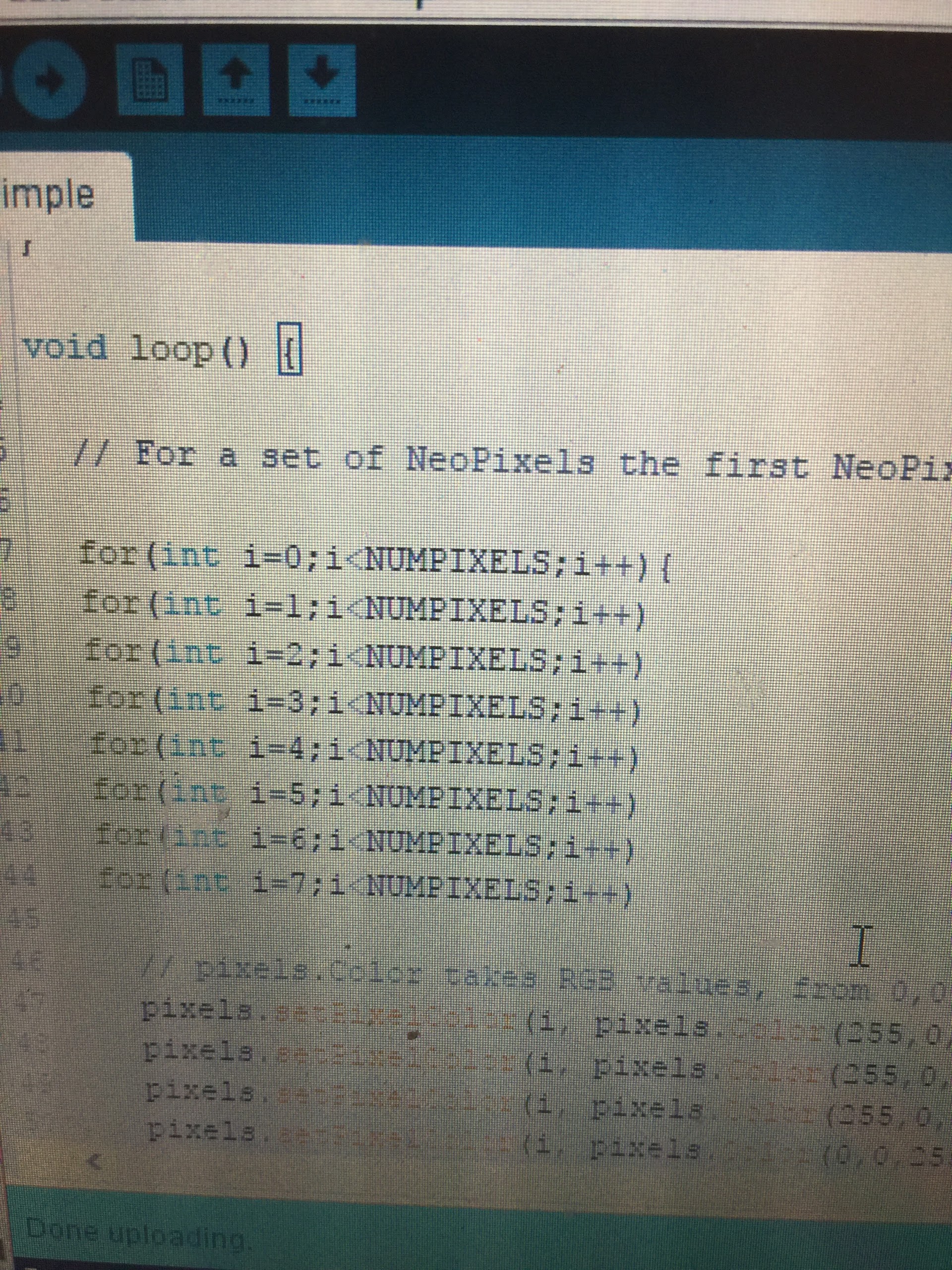

G+_Donald Kloss Posted October 23, 2017 Share Posted October 23, 2017 Does this look right, I’m trying to program a certain amount of leds on a ws2812 strip, I tried changing letters same result I’m using the simple code from adafruit Link to comment Share on other sites More sharing options...
G+_William L. DeRieux IV Posted October 23, 2017 Share Posted October 23, 2017 I am by no means an expert, but that loop looks rather redundant and it is not really done very well.... I would have thought that adafruit would write code that made sense (or at least would have had better documentation), but I guess not. I think you can find a way to write that so it can be followed more easily. Link to comment Share on other sites More sharing options...

G+_Donald Kloss Posted October 23, 2017 Author Share Posted October 23, 2017 William L. DeRieux IV I think I might have figured it out by using different letters it’s a simple code just had to try a bunch of other stuff, trying to get it done before Halloween so hopefully I can make it more compact when I need it later on because it’s going to be a 30 led strip Link to comment Share on other sites More sharing options...
G+_William L. DeRieux IV Posted October 23, 2017 Share Posted October 23, 2017 Donald Kloss I don't know what you mean by "different letters". Do you mean that you took adafruit's code and modified it ? Are you trying to test 8 leds and have each one sweep through all RGB values, or something like that ? as David Peach said it would help to see the actual adafruit code sample (as well as your entire code) Link to comment Share on other sites More sharing options...
G+_Fr. Robert Ballecer, SJ Posted October 23, 2017 Share Posted October 23, 2017 Yeah... can you github or pastebin the code? Also... tell us what you actually want the string to do... we've got plenty of expertise in this group and we can get you on the right path pretty quickly. :) Link to comment Share on other sites More sharing options...

G+_Donald Kloss Posted October 23, 2017 Author Share Posted October 23, 2017 hopefully this works this is the file i uploaded to github, what im trying to do is static LED colors for each LED on the strip, I didnt have time to purchase single color strips, github.com - dkloss28/LEDStrip Link to comment Share on other sites More sharing options...

G+_Donald Kloss Posted October 23, 2017 Author Share Posted October 23, 2017 here is the pastebin version https://pastebin.com/vbe7WkvC Link to comment Share on other sites More sharing options...
G+_William L. DeRieux IV Posted October 23, 2017 Share Posted October 23, 2017 Donald Kloss You only committed .gitattributes I see that you posted the code on pastebin... Like I said, it is hard to determine what you are trying to accomplish (just by looking at the code). You might want to add some comments (ie documentation) as to what is going on and to state what you are doing. From what you said earlier: "what im trying to do is static LED colors for each LED on the strip". I think you could just set the led colors directly without using a nested for loop the way that you have (this is a non-standard use of a for loop), for this application you should probably use a while loop instead and set your colors inside of that for each pixel, possibly even making use of a function to handle setting the colors by passing in the relevant data. Link to comment Share on other sites More sharing options...
G+_Ben Reese Posted October 23, 2017 Share Posted October 23, 2017 If I'm understanding the code correctly, it will loop through all the pixels and change them in a chase pattern. Assuming RGB; the first pass will go blue, blue, blue, red, green, light blue, orange. Following loops will move that pattern down the string of lights. I haven't had the opportunity to test the lights myself (hoping to get some soon), so I'm not sure whether the beginning lights will stay blue as they were originally set, or default to off since so value was given. Link to comment Share on other sites More sharing options...
G+_Ben Reese Posted October 23, 2017 Share Posted October 23, 2017 You mentioned static colors. Do you want them all the same color or different colors? If different colors but static, I think the easiest way would be just something like..... pixels.setPixelColor(0, pixels.Color(0,0,255)); pixels.setPixelColor(1, pixels.Color(0,255,255)); pixels.setPixelColor(3, pixels.Color(255,0,255)); pixels.setPixelColor(4, pixels.Color(0,255,0)); ... ... pixels.setPixelColor(9, pixels.Color(255,255,255)); If instead you want them all the same color, you could do it like above or with one for loop: for(int a=0;a pixels.setPixelColor(a, pixels.Color(0,0,255)); } pixels.show(); ... Like I said, no experience so I don't know if this would even work or if I'm understanding it correctly, but hopefully it helps. Link to comment Share on other sites More sharing options...
G+_Telford Dorr Posted October 23, 2017 Share Posted October 23, 2017 A recommendation on code commenting: the most useful comment is a block comment before a section of code that explains, in general terms, what the block is trying to accomplish. Unless it's already done elsewhere. include a description of the data or parameters used by the code block and what it is supposed to contain (including value ranges, if appropriate). This makes it easier for future maintainers of your code (including you) to figure out down the road what you were thinking when you wrote the code. What you don't want to do is try to describe individual lines of code. Someone reading the listing can determine that from the preceding comment block. Regarding the code: if (a) you're trying to make all LEDs the same color, set the color values outside of the for loop, then inside the for loop write the same data n times, where n = number of LEDs in the chain. if (b) you're trying to have each LED a different color, use the index value from the for loop (in this case, i) to select the color from an array of fixed color values and then write those values to the LED chain. The LED order is the same as the data table order. In either case, a single for loop should be all that is needed. Hope this helps. Link to comment Share on other sites More sharing options...
G+_Jim Hofmann Posted October 23, 2017 Share Posted October 23, 2017 I don't have any ws2812's to test with so ... Need to get some. Still not sure what your trying to do but I modded your loop. This "should" create a lite chase with 2 pixels off. It loops thru the 'for' loop then repeats the main loop. Only one var, 'a', start of the 7 pixels. Good Luck. Opps, fixed count. void loop() { // For a set of NeoPixels the first NeoPixel is 0, second is 1, all the way up to the count of pixels minus one. //This "should" cause a lite chase with 2 off pixels for(int a = 0; a < NUMPIXELS; a++) { // pixels.Color takes RGB values, from 0,0,0 up to 255,255,255 pixels.setPixelColor(a, pixels.Color(0,0,255)); // Moderately bright green color. pixels.setPixelColor((a+1)%10, pixels.Color(0,0,255)); pixels.setPixelColor((a+2)%10, pixels.Color(0,0,255)); pixels.setPixelColor((a+3)%10, pixels.Color(140,45,14)); pixels.setPixelColor((a+4)%10, pixels.Color(0,255,0)); pixels.setPixelColor((a+5)%10, pixels.Color(95,224,233)); pixels.setPixelColor((a+6)%10, pixels.Color(255,128,0)); pixels.setPixelColor((a+7)%10, pixels.Color(0,0,0)); pixels.setPixelColor((a+8)%10, pixels.Color(0,0,0)); pixels.setPixelColor((a+9)%10, pixels.Color(0,0,0)); pixels.show(); // This sends the updated pixel color to the hardware. delay(delayval); // Delay for a period of time (in milliseconds). } } Link to comment Share on other sites More sharing options...

G+_Jim Hofmann Posted October 23, 2017 Share Posted October 23, 2017 If you're feeling adventurous. Add an array of the static colors and then index thru them and assign. Problem with coding, there's always another way :). int delayval = 500; // delay for half a second int colorsRGB[NUMPIXELS][3] = { {0,0,255}, {0,0,255}, {0,0,255}, {140,45,14}, {0,255,0}, {95,224,233}, {255,128,0}, {0,0,0}, {0,0,0}, {0,0,0} }; void loop() { //This "should" cause a lite chase with 3 off pixels for(int pixelStart = 0; pixelStart < NUMPIXELS; pixelStart++) { // pixels.Color takes RGB values, from 0,0,0 up to 255,255,255 for(int pixel = 0; pixel < NUMPIXELS; pixel++) { pixels.setPixelColor((pixelStart + pixel) % 10, pixels.Color(colorsRGB[pixel][0], colorsRGB[pixel][1], colorsRGB[pixel][2] )); } pixels.show(); // This sends the updated pixel color to the hardware. delay(delayval); // Delay for a period of time (in milliseconds). } } Link to comment Share on other sites More sharing options...
