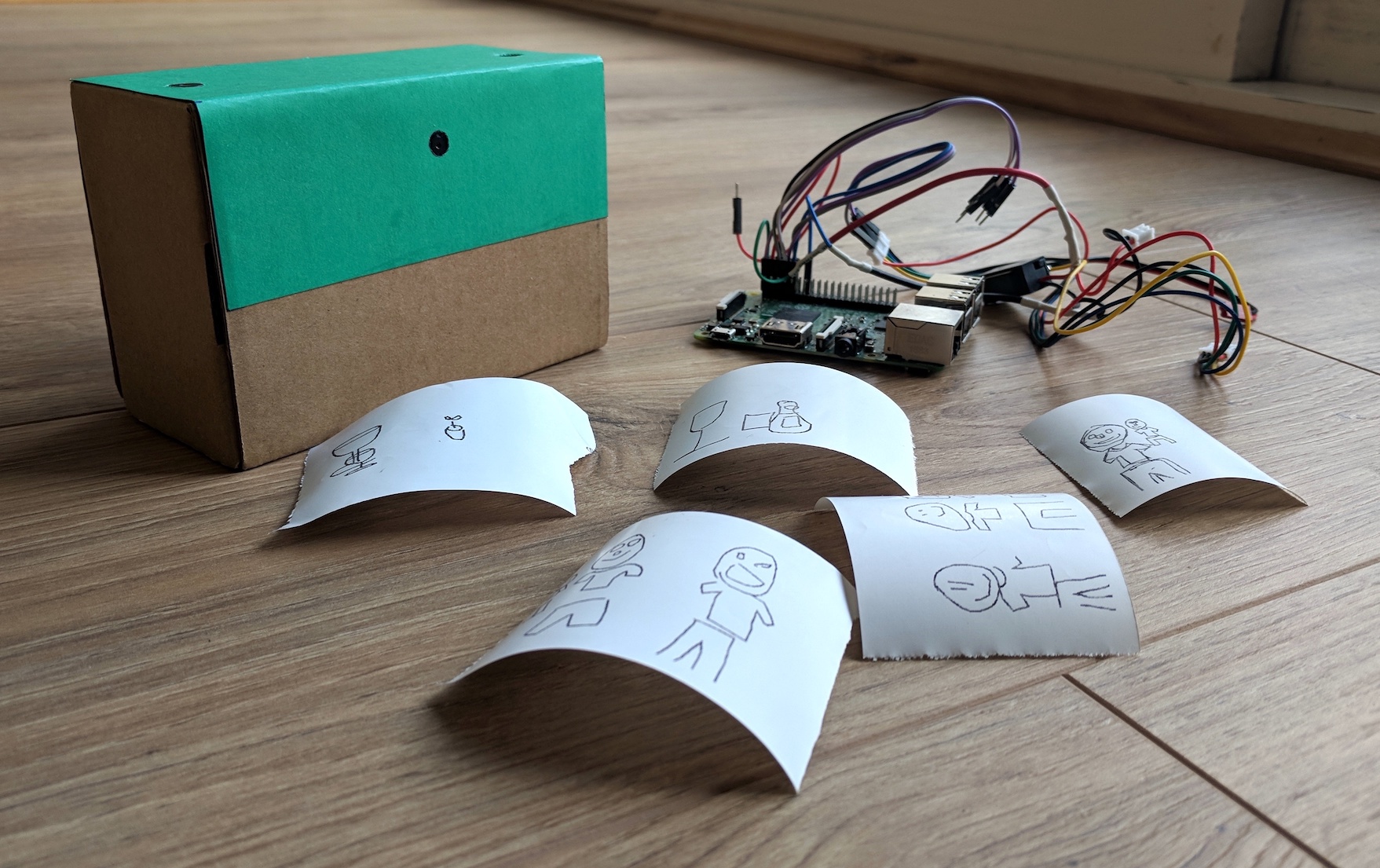

G+_Mark Olson Posted July 22, 2018 Share Posted July 22, 2018 WOW! I gotta build one of these! I first saw it here: https://techcrunch.com/2018/07/06/your-next-summer-diy-project-is-an-ai-powered-doodle-camera/ Link to comment Share on other sites More sharing options...
G+_Jeff Gros Posted July 22, 2018 Share Posted July 22, 2018 Oh ok. It uses some cloud AI to process the picture and then send back ANOTHER picture (which might not look anything like the original) to print. It wasn't very clear to me from the article. I knew nothing about the AI and saw an arduino, and wondered how the arduino could do all of this. Something similar, like OCR (optical character recognition), on a raspberry pi 3B+ takes like 10 seconds. Cannot imagine it on an arduino. Cloud processing to the rescue. Link to comment Share on other sites More sharing options...
G+_Mark Olson Posted July 23, 2018 Author Share Posted July 23, 2018 I don't know everything about it, but I think there is a Raspberry Pi for the processing. I don't see an Arduino in the github repository "schematic"; I think that board in the picture is a Raspberry Pi. After I get a chance to look at the code I hope to figure out if it is doing the processing in the cloud. Link to comment Share on other sites More sharing options...
G+_Mark Olson Posted July 23, 2018 Author Share Posted July 23, 2018 There is some Arduino code that seems to be designed to turn on/off or blink LEDs during certain time periods, but I don't think it is actually used. The LED is wired into the Raspberry Pi. Also, there is a website that allows you to test the AI code online against a picture but so far it looks like the AI code (based on Google TensorFlow) would run directly on the Raspberry Pi. Also, the hardware part of this project seems to be based on this AdaFruit project: learn.adafruit.com - Overview | Instant Camera using Raspberry Pi and Thermal Printer | Adafruit Learning System Link to comment Share on other sites More sharing options...
G+_Jeff Gros Posted July 23, 2018 Share Posted July 23, 2018 Oops. You're right. It does look like a raspberry pi in the picture. I just looked at the github, saw arduino and moved on. Had I bothered to actually hit the scroll button ONCE, I would have seen some raspberry pi stuff. How embarrassing! :) From what I can tell, it looks like a google open source library tensor flow for the AI. Still, I wonder about what the response time is to process the image. Care to try it out? ;) Link to comment Share on other sites More sharing options...

G+_Jeff Gros Posted July 28, 2018 Share Posted July 28, 2018 I'm interested in the printer. Not sure what the printer actually is, but looking at the python code, I can see it uses the ESC/POS protocol. That doesn't necessarily mean it is an Epson under the hood though, as other brands support the protocol as well. Can you peek under the hood and see if there's any identifying marks inside? Link to comment Share on other sites More sharing options...
G+_Mark Olson Posted July 28, 2018 Author Share Posted July 28, 2018 Jeff Gros I guess I actually got the Nano Thermal Receipt Printer – TTL Serial. You can see details (https://blog.adafruit.com/2015/12/21/new-products-tiny-thermal-receipt-printer-nano-thermal-receipt-printer-thermal-receipt-printer-guts-thermal-paper-roll-33-long-thermal-paper-roll-16-long/) about halfway down the page. I don't see any identifying marks in those pictures (much better than anything I would do) or looking at my printer. My guess: not Epson. Link to comment Share on other sites More sharing options...
G+_Jeff Gros Posted July 28, 2018 Share Posted July 28, 2018 Cannot tell. The processor is NXP, and there is either Chinese or Japanese for silkscreen (I cannot read either one). Head might be sold separately, but I don't see any markings. Link to comment Share on other sites More sharing options...
