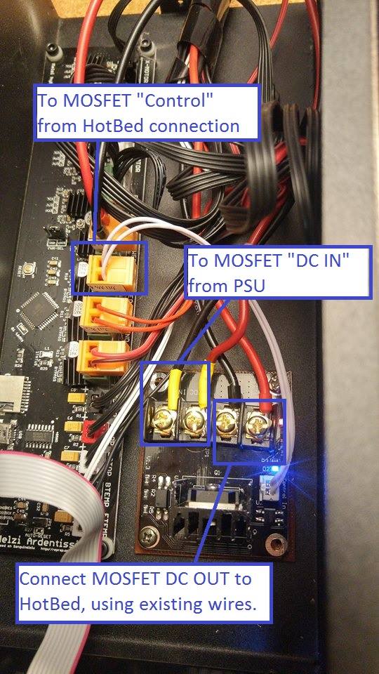

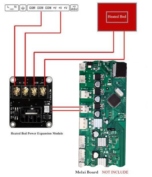

G+_Shooter_FPV (Shooter_FP Posted April 21, 2017 Author Share Posted April 21, 2017 Joseph Politi Funny, read up on the MOSFET mod earlier today. Already in my cart on Amazon. Just can't seem to find a proper wiring diagram. I know it's easy to set up, just need to do it right. Any links on proper wiring? Link to comment Share on other sites More sharing options...
G+_Joseph Politi Posted April 22, 2017 Share Posted April 22, 2017 I have it on my computer. I'll put it up later for you. Link to comment Share on other sites More sharing options...
G+_Joseph Politi Posted April 23, 2017 Share Posted April 23, 2017 Ken Jancef Link to comment Share on other sites More sharing options...
G+_Joseph Politi Posted April 23, 2017 Share Posted April 23, 2017 there is a very small + on the mosfet for the white control connection to the melzi board. The rest of the wires are easy to see Link to comment Share on other sites More sharing options...
G+_Shooter_FPV (Shooter_FP Posted April 23, 2017 Author Share Posted April 23, 2017 Thanks!!! :) I'm ordering the MOSFET now... Link to comment Share on other sites More sharing options...
