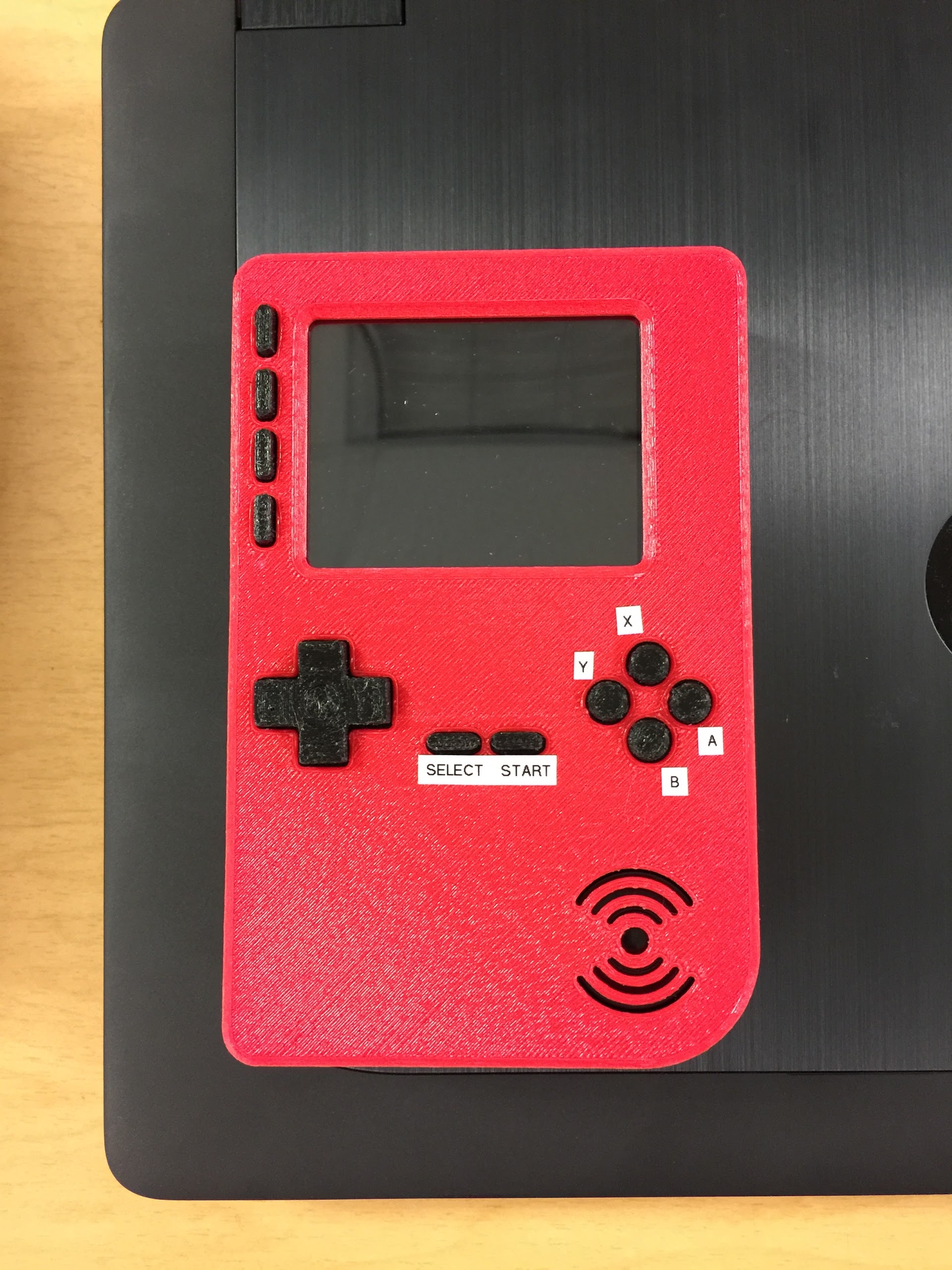

My latest build...
PiGRRL 2... 3D printed the parts, and Adafruit sells a kit with all parts except the Pi for $60. They also have a kit that includes a Pi, forgot the price. I already had a Pi 2 collecting dust. The buttons and D-Pad were printed with NinjaFlex... took me almost a week to get those printed right.
I do have one issue, and it seems like a common one with this build: the battery can cause audio interference, so they say to wrap the battery in foil, then run a copper wire from it to one of the boards. I haven't done that yet... all-in-all it was a good project...
