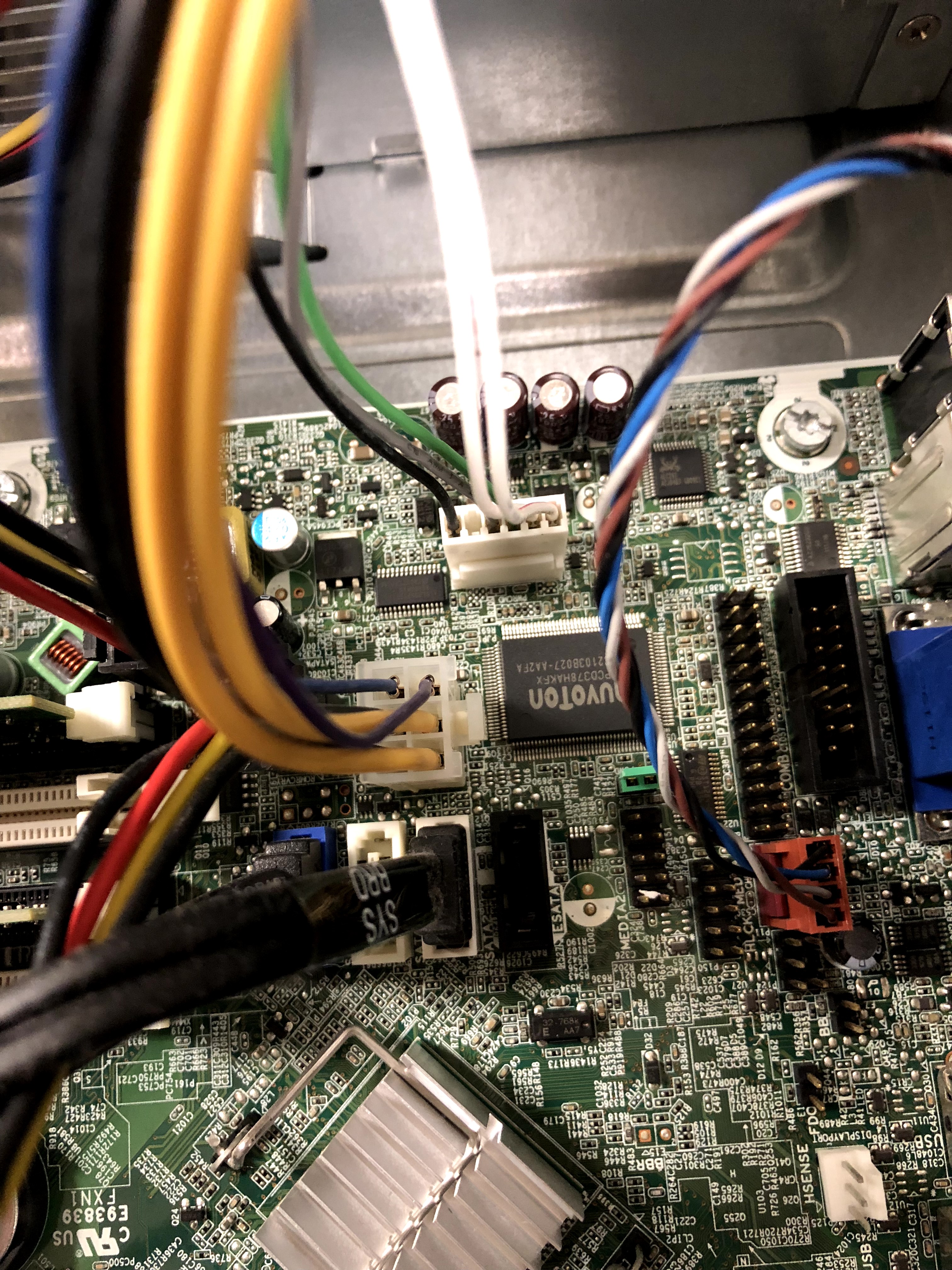

G+_Shooter_FPV (Shooter_FP Posted October 26, 2017 Author Share Posted October 26, 2017 Ben Reese Chris Skinner Chris' idea should work, that's the type of connector that my system has. It's beyond me why HP would go proprietary. For about the same price I could go with the Add2PSU, but I think the adapter cable may be a better idea. Link to comment Share on other sites More sharing options...
G+_Shooter_FPV (Shooter_FP Posted October 26, 2017 Author Share Posted October 26, 2017 This is the power connector in the system... Link to comment Share on other sites More sharing options...

G+_Shooter_FPV (Shooter_FP Posted October 30, 2017 Author Share Posted October 30, 2017 Ben Reese Someone else posted a link to something similar. In the reviews of the other one, a lot of people said they had to change the wiring order of the 6-pin connector, and even sort of "offset" the other white connector. Right now I have the second power supply running with the green/black wires on the 24-pin jumpered and wrapped with tape. I make sure to shut my computer down at night, just in case. I'll do this until I think about what I want to do, either the connector you linked to, or the Add2PSU. Link to comment Share on other sites More sharing options...
