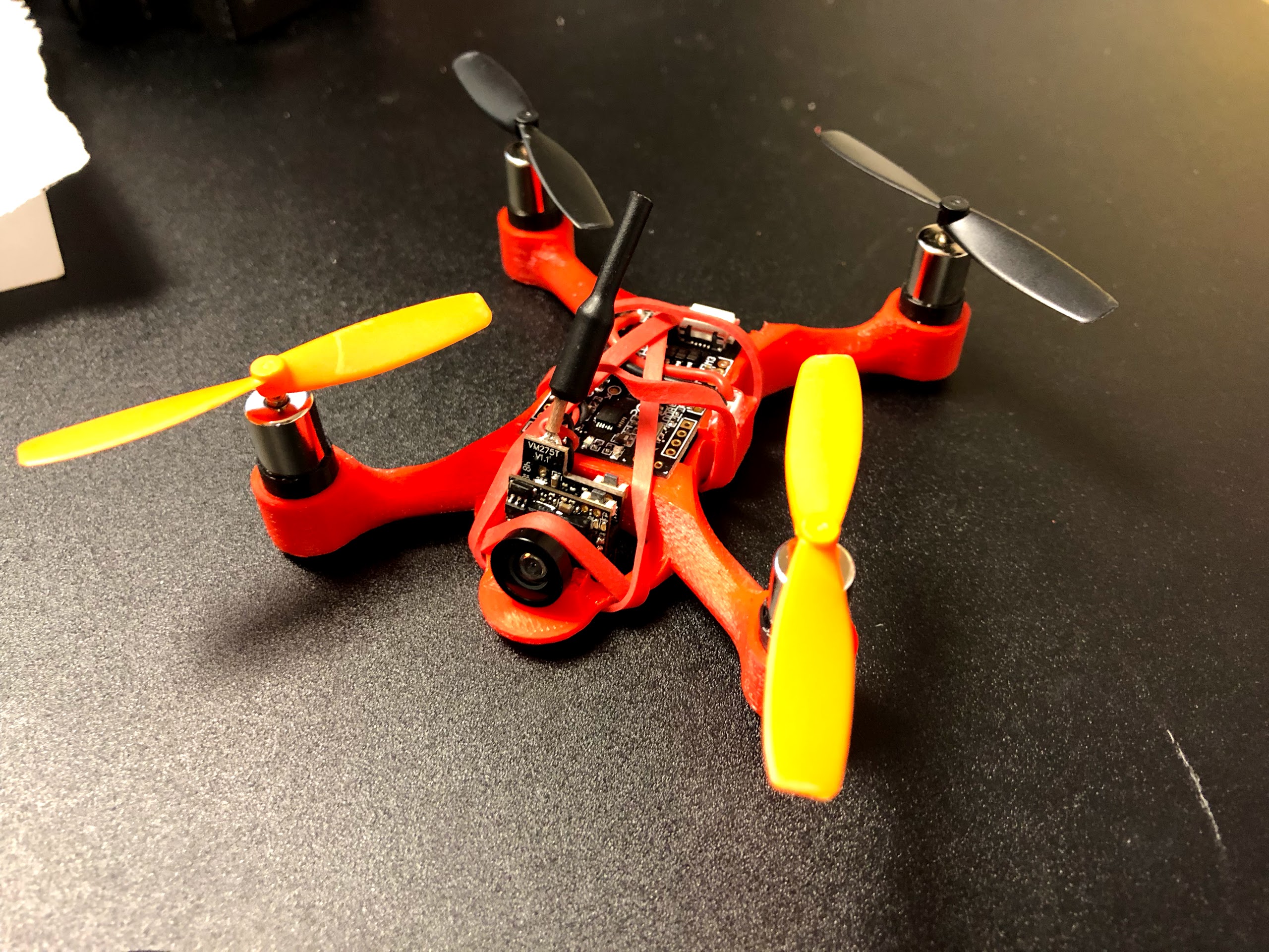

G+_Shooter_FPV (Shooter_FP Posted December 13, 2017 Share Posted December 13, 2017 Another drone build... in the “Tiny Whoop” class. 95mm 3D printed frame, 8.5mm motors, and of course FPV. And for such a tiny thing... it MOVES! A little too fast for me, but great to learn with. And a pretty easy build... Link to comment Share on other sites More sharing options...

G+_Shooter_FPV (Shooter_FP Posted December 14, 2017 Author Share Posted December 14, 2017 John D. Hawkins Not really. The frame is 3D printed. The flight controller was maybe $11, and the receiver was, I think, less than $10. I did pay $27 for the motors, but that's because I have 2 smaller Tiny Whoops, and I get my motors from a place that specializes in small quad motors. The hardest part is the soldering. Since the parts are small, the solder spaces are pretty tight. And the motor wires being thin doesn't help. And as I said earlier, this thing is FAST. I ordered 5 sets of props just in case. I'm not used to something this fast, but it's great fun to fly. If you have any questions, please feel free to ask... if you're going to build it I can give you links to what I bought. Link to comment Share on other sites More sharing options...

G+_Shooter_FPV (Shooter_FP Posted December 14, 2017 Author Share Posted December 14, 2017 Flight Controller: https://www.banggood.com/Eachine-32bits-F3-Brushed-Flight-Control-Board-Based-On-SP-RACING-F3-EVO-For-Micro-FPV-Frame-p-1076530.html?rmmds=myorder&cur_warehouse=CN Receiver: https://www.banggood.com/Eachine-Tiny-QX90-Quadcopter-Parts-Frsky-8CH-PPM-SBUS-Receiver-Compatible-Frsky-X9D-PLUS-X9E-DJT-DFT-p-1079410.html?rmmds=myorder&cur_warehouse=CN Motors: https://micro-motor-warehouse.com/collections/all-motors/products/cl-0820-15 FPV Camera: https://www.amazon.com/gp/product/B01MXTY646/ref=oh_aui_detailpage_o00_s00?ie=UTF8&psc=1 Frame: https://www.myminifactory.com/object/mk-xiii-micro-quad-28907 Link to comment Share on other sites More sharing options...
G+_Shooter_FPV (Shooter_FP Posted December 14, 2017 Author Share Posted December 14, 2017 One note: The black pieces surrounding the motors are motor mounts, and he suggests printing in NinjaFlex, which I did. If you can't print in NinjaFlex, he has them for sale on his website for, I believe, $5. Link to comment Share on other sites More sharing options...

G+_Shooter_FPV (Shooter_FP Posted December 14, 2017 Author Share Posted December 14, 2017 John D. Hawkins I think I just did 100% infill, being that it would be stronger for the way I fly (crash)... the one problem I had was that in front, where the camera is, the mount extends up on both sides to fit the camera in between. Well I tried 3 different slicer programs, and for some reason those side pieces print so weak that they just snap off. You can probably see that in my picture... It’s ok, because there’s enough of that mount left that the camera fits in perfectly anyway. Hope that made sense... ? Link to comment Share on other sites More sharing options...
