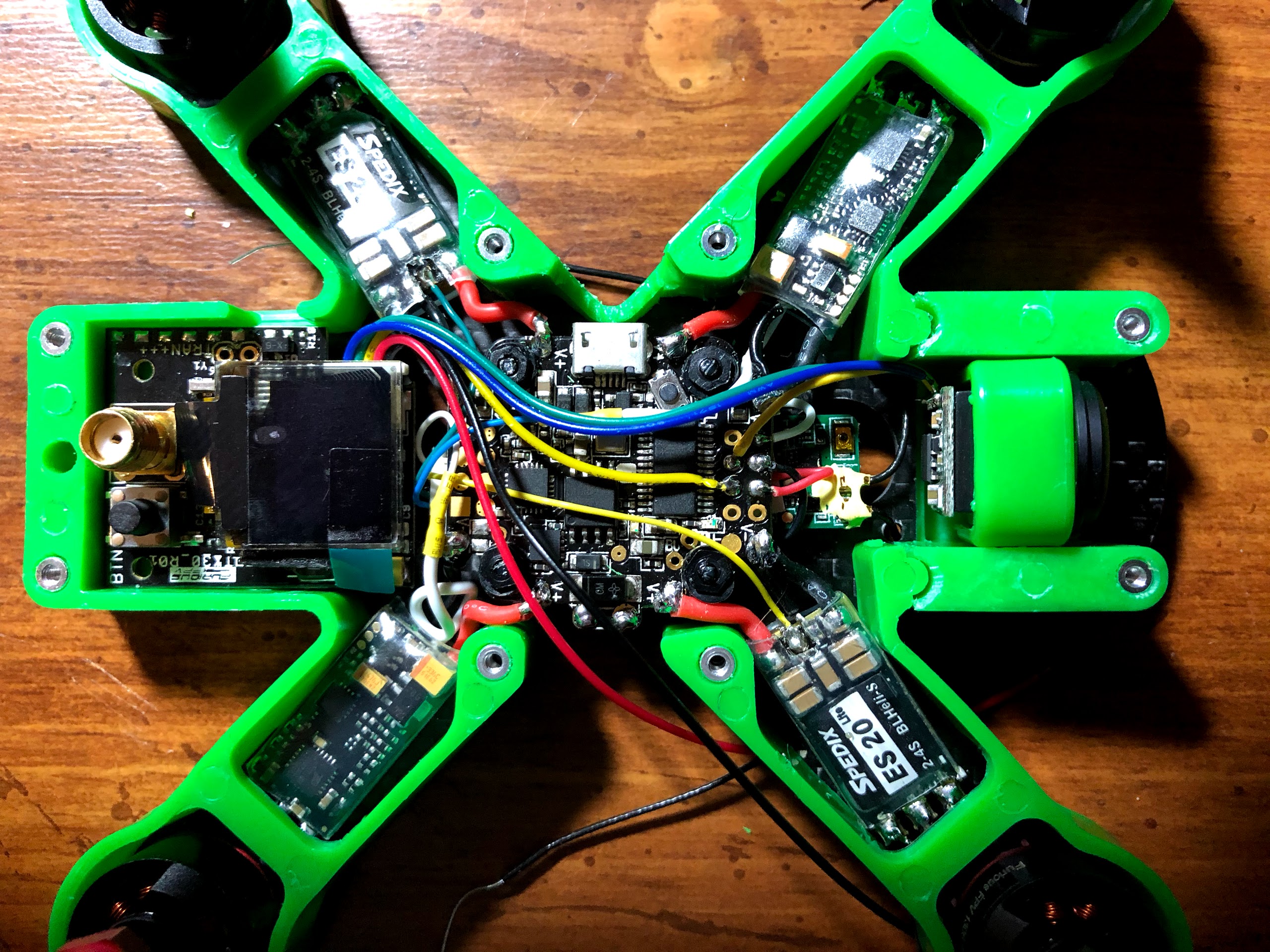

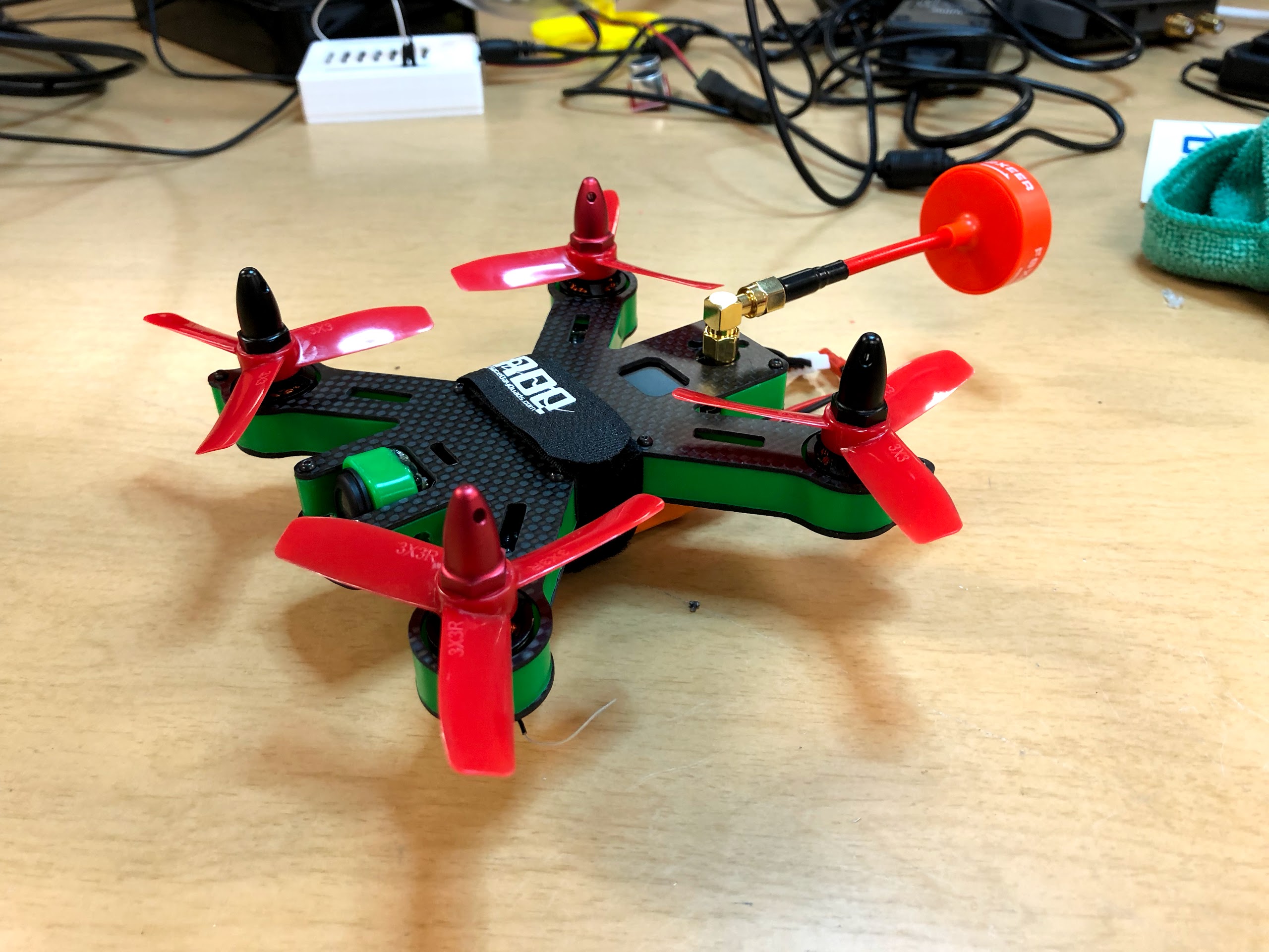

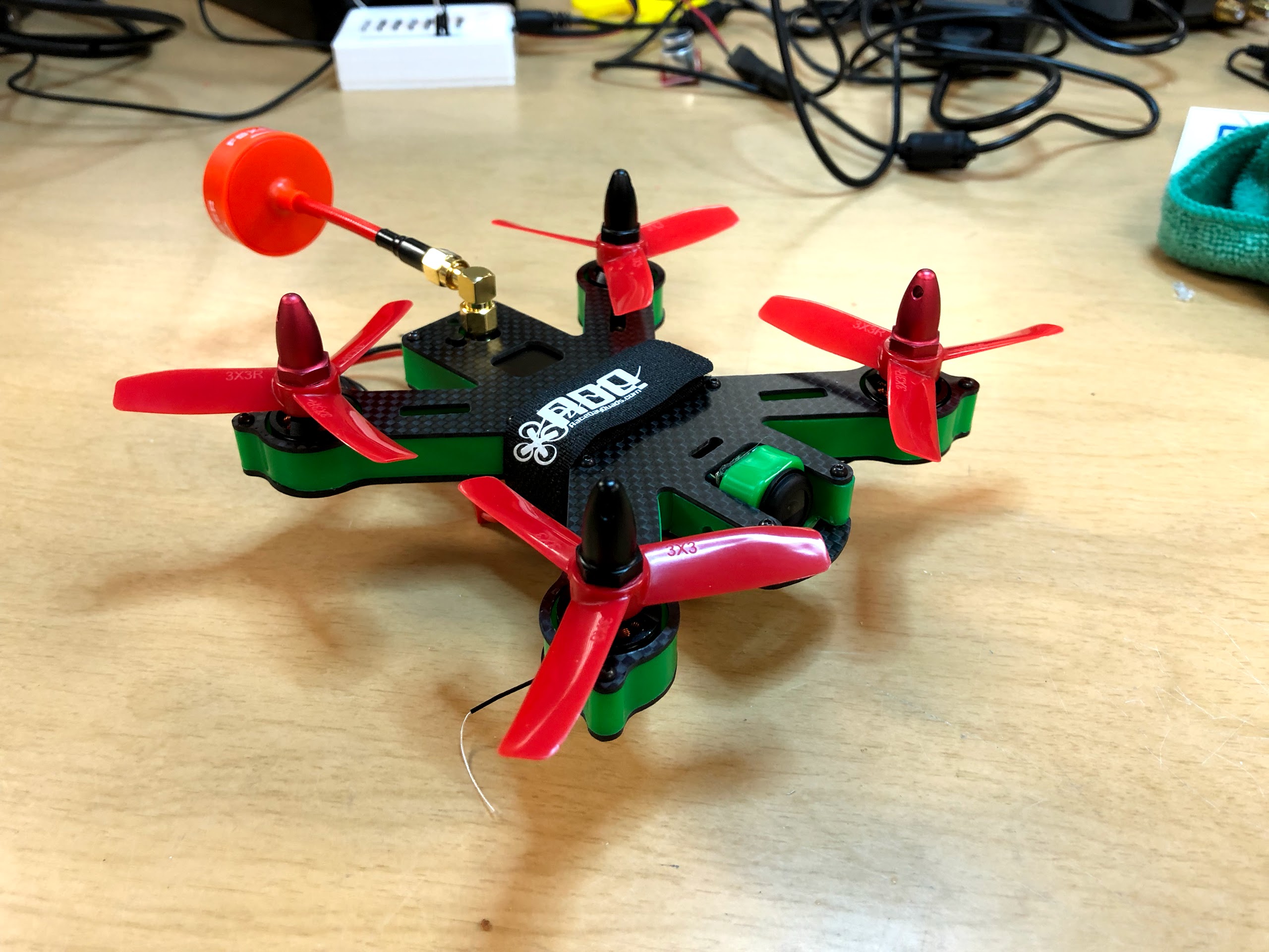

G+_Shooter_FPV (Shooter_FP Posted February 23, 2018 Share Posted February 23, 2018 Another quad build... this one took me a few months due to the size, and ordering parts was tough. It’s aFuriiusFPV Toretto 130. You can buy it pre-built, but what’s the fun in that?? 80% of the parts were on clearance, they just took a long time to come in. And the space for the electronics was REALLY tight, so soldering wasn’t too fun. I also got a crash course in configuring/updating ESC firmware. I just love how sleek it looks... I have a parts list if anyone wants it... Link to comment Share on other sites More sharing options...

G+_Brian “Yikesfpv” Gipe Posted February 25, 2018 Share Posted February 25, 2018 Dig it, man! Careful w/ those SMA connectors. Might snap after a few crashes. Link to comment Share on other sites More sharing options...
G+_Shooter_FPV (Shooter_FP Posted February 25, 2018 Author Share Posted February 25, 2018 Jason Thomas Realized my work computer is off for the weekend. If I have time I’ll re-do it, but if not I’ll post it up tomorrow morning... Link to comment Share on other sites More sharing options...
G+_Shooter_FPV (Shooter_FP Posted February 25, 2018 Author Share Posted February 25, 2018 Brian Gipe Yea, really had no choice though... that’s why I went with the 90° adapter for it. The “original” has a tall antenna that’s just begging to be snapped Link to comment Share on other sites More sharing options...

G+_Shooter_FPV (Shooter_FP Posted February 26, 2018 Author Share Posted February 26, 2018 Jason Thomas Here is the parts list: FuriousFPV Toretto 130 frame DYS F4 Mini FC Spedix ES20 Lite ESC FuriousFPV 1306 4000Kv motors FuriousFPV 3030 props FuriousFPV VTX T130 VTx FuriousFPV 1/4 CMOS 700VTL FPV 150 Degree Wide Angle Lens Camera ReadyMadeRC 3S 1,100mAh battery Foxeer Pagoda antenna Link to comment Share on other sites More sharing options...
G+_Shooter_FPV (Shooter_FP Posted February 26, 2018 Author Share Posted February 26, 2018 Jason Thomas No problem. If you do decide to build it, let me know and I'll do my best to help. Oh dang! Almost forgot... I had to order M2x5 screws to put the body together. and here's a link to some of the parts: helidirect.com - Search results for: 'toretto' Link to comment Share on other sites More sharing options...
