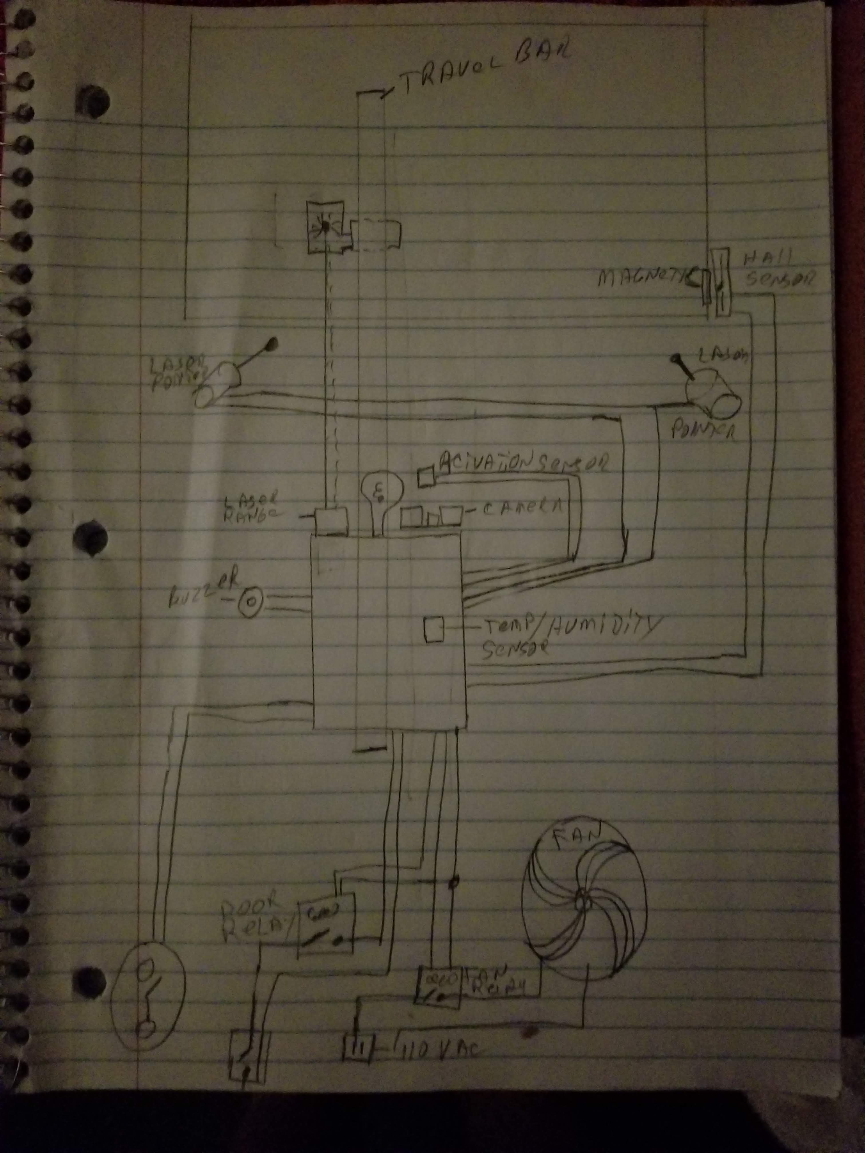

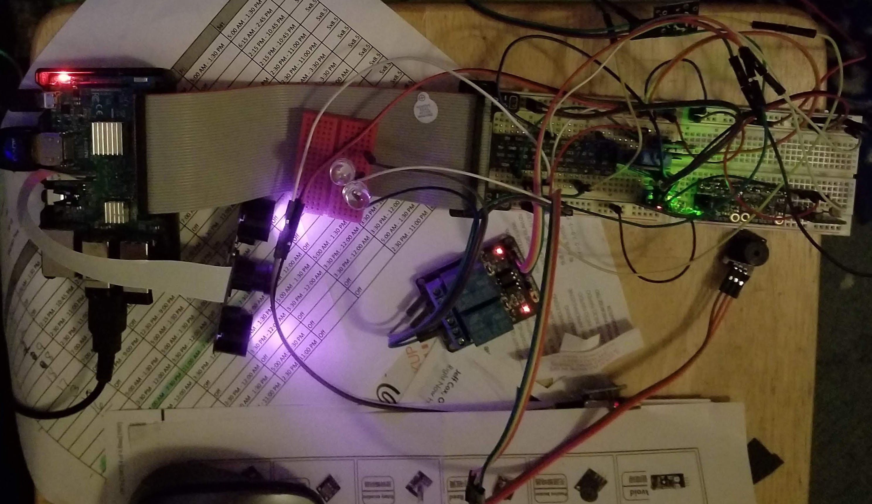

G+_Nathan Dixon Posted June 19, 2018 Share Posted June 19, 2018 Padre, All This is a general plea for help, I have relatively ambitious project to control/update my garage. My house is on a N/S axis with my garage getting the most of the summer sun. With that said, I am trying to do about 5 things with this setup: 1: Get a camera looking at the door that is at least accessible from the house network. 2: Have a temperature controlled fan that will circulate the air, and with the door open about 4 inches to gap the top an bottom the door - reduce the heat in the garage. The fan is placed to blow air across the top of the garage. 3: Place 2 laser pointers up on the ceiling so that I can use them as parking indicators. the lasers will only be on if the garage door opener light is on. 4: If the garage is left open; close the door after a period of time. A bypass switch also so that it can be left open when needed. 5: the satisfaction of doing it myself - not a bunch of mass marketed devices I have all the parts, and electrically they appear good, but I just cannot get the python script to run properly. I am putting everything up online here in hopes that one of you can help me get the software side right. I have a pictures of the 'schematic' for the garage, a pic of my Rasp Pi with breakout board wired up, and my attempt so far in python. please help. Polartraveler #!/usr/bin/python import sys import AdaFruit_DHT import gpiozero import time #from time import strftime #pin defintions from a Rasp Pi 3B doorrelaypin = 17 # GPIO17 buss pin 11 fanrelaypin = 27 # GPIO27 buss pin 13 hallsensorpin = 23 # GPIO23 buss pin 16 lightactivationpin = 24 # GPIO24 buss pin 18 pointerpin = 25 # GPIO25 buss pin 22 #laserrngfinder = I2c # GPIO3 GPIO4 laserrngfinderpin = 16 # GPIO16 buss pin 36 buzzerpin = 5 # GPIO5 buss pin 5 bypasspin = 6 # GPIO6 buss pin 6 print 'pin definitions' #variable setup bypass = 0 # is the autoclose timer bypassed (0/1) videoflag = 1 # is the video on or off (0/1) sleeptime = 5 # the door delay timer minutecompare = 0 # a holding variable to check the minutes waited. minutecompare1 = 0 # a holding variable to check the minutes waited farcel = 'F' # farenheight temp returns #farcel = 'C' # celsius temp returns # Pin setup doorrelay = DigitalOutputDevice(doorrelaypin,initial_value(False)) fanrelay = DigitalOutputDevice(fanrelaypin,initial_value(False)) pointer = LED(pointerpin,initial_value(False)) buzzer = Buzzer(buzzerpin, initial_value(False)) lightactivation = LightSensor(lightactivationpin) bypass = Button(bypasspin,pull_up(False) laserrngfinder() = LightSensor(laserrngfinderpin) hallsensor() = LightSensor(hallsensorpin) Class VideoOn: def int(flag, hold): if (flag == 1) if (hold == 0) #raspivid -t 0 -l -o tcp://0.0.0.0:3333 #original line raspivid -s -t 0 -l -o tcp://0.0.0.0:3333 hold = 1 else return else kill -USR1 (pgrep raspvivid) return def gettemphumid:minutecount,farcel tempreading[9] humidity: #int(temphold): humidity,temperature[minutecount] = Adafruit_DHT.read_retry(11, tempsensorpin) temphold = 0 for loop in range (0 to 9): temphold += tempreading[loop] # calculates the 10 min average temphold /= 10.0 # determines if the output is farenheight or celsius if (farcel == 'F') temphold *= (9 / 5.0) + 32 # print the resulting 10 min temp/humidity print 'Temp: {0:0.1f} ' farcel ' Humidity: {1:0.1f} %'.format(temphold, humidity) return temphold # checks for light and if it is on turns on the pointers def checklight: if (lightactivation.light_detected() = 'False'): # button is released pointer.off() else: # button is pressed: pointer.on() # Check for bypass push def checkbypass: if (bypass.is_pressed() = 'False'): # button is released return 0 else: # button is pressed: return 1 # Check for hallecect sensor on def checkhallsensor: if (hallsensor.light_detected() = 'False'): # button is released return 0 else: # button is pressed: return 1 # door status def doorstatus: # reading the status of the distance/avoidance sensor to determine if the door is open dooropen = laserrngfinder if (dooropen >> 1 ): print 'check door' if (bypass >> 1): print 'close door' return 2 else: bypass += 1 print 'bypass close door' return 1 else: print 'door is closed' bypass = 0 return 0 ''' the door status section above I am trying to swap out with a VL53L0X sensor in long range mode. with the sensor in long range mode I can read the distance of target and get a better understanding of the door location. ''' main: while 1: minutecount = int( strftime(%M) ) checklight: # check to see if the light is on if (int(minutecount/10) != minutecompare): minutecompare = int(minutecount/10) if (gettemphumid(minutecount,farcel) > 70): fanrelay.on() print 'fan on' else: fanrelay.off() print 'fan off' if (doorstatus == 1): # check the doorsensor for open door if (minutecompare1 << 0): minutecompare1 = sleeptime + minutecount elif: if ( (minutecompare1 - minutecount) << 2) buzzer.on() else: buzzer.off() else: if ( (minutecompare1 - minutecount) == 0) buzzer.on() #the blink is an attempt to save code doorrelay.blink(on_time=.01, offtime=0 n=1) #doorrelay.on() #time.sleep(0.015) #doorrelay.off() else: if ( (minutecompare1 - minutecount) >> 0) buzzer.on() else: buzzer.off() minutecompare1 = -1 if ((gettemphumid(minutecount,farcel) > 70) && checkhallsensor): #the blink is an attempt to save code doorrelay.blink(on_time=.01, offtime=0 n=1) #doorrelay.on() #time.sleep(0.015) #doorrelay.off() # Video output and control # remote toggle video flag - still in works VideoOn(videoflag) Link to comment Share on other sites More sharing options...
