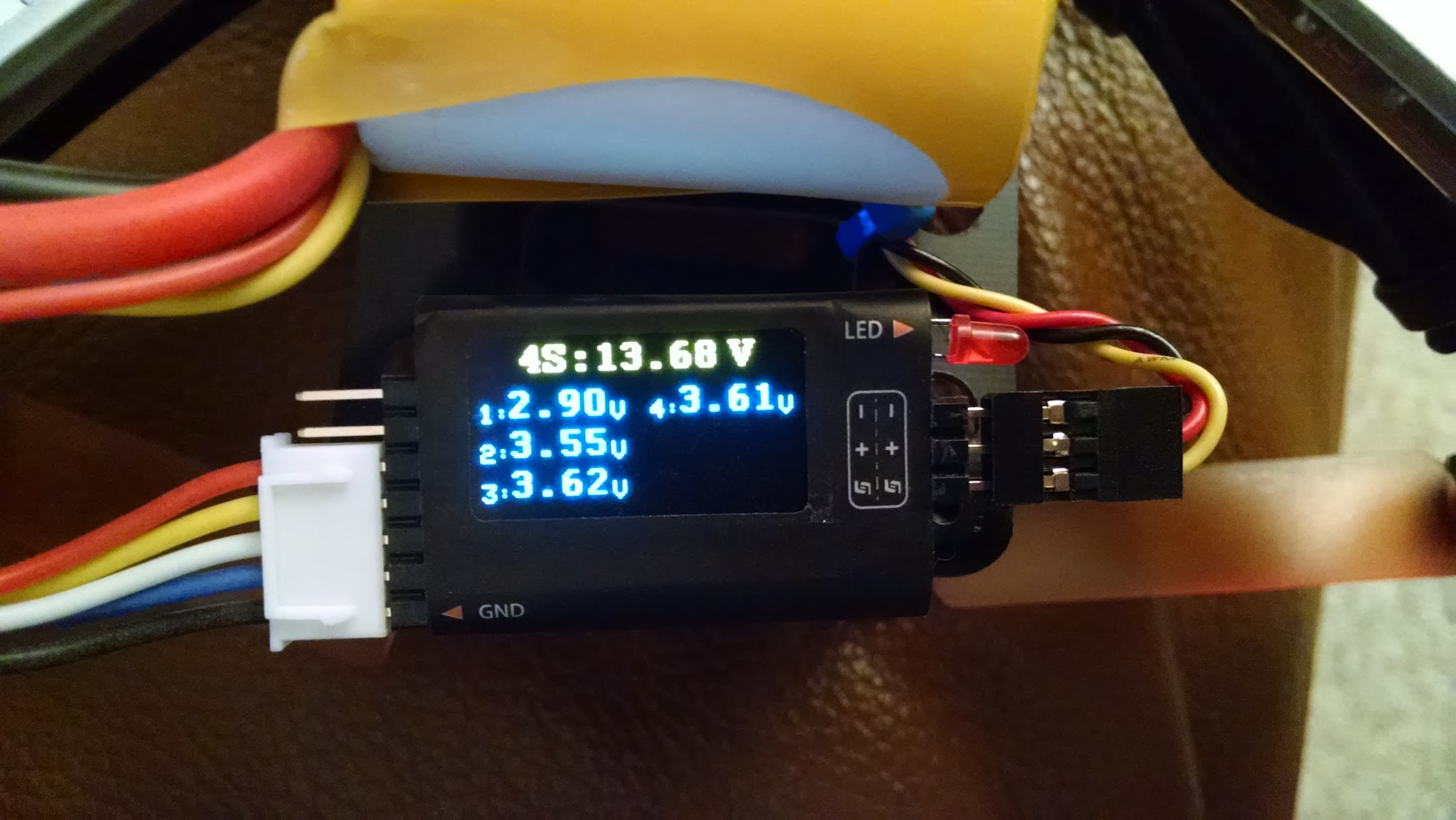

G+_Steve Prior Posted July 26, 2015 Share Posted July 26, 2015 I bought the ZIPPY Compact 2700mAh 4s 60c Lipo Pack for my KH250 build (and the FrSky voltage telemetry sensor). I balance charged the pack before I flew, then after flying for a few minutes the drone seemed more sluggish - I checked the battery and it seems that the first cell is down to 2.9V while the rest are above 3.5V. This happened twice so far. The battery hasn't been in a crash and has no damage. Did I get a bad battery? Link to comment Share on other sites More sharing options...

G+_Steve Prior Posted August 1, 2015 Author Share Posted August 1, 2015 OK, this is getting strange. I received a new 3S pack today, balance charged it and flew. When I was done I noticed that the first cell was significantly lower then the other two. I balance charged it again, flew and saw the same result. One bad pack I can understand, but two seems like too much of a coincidence, though aside from the FrSky voltage sensor connected via the balance port there should be no way the quad's wiring could affect one cell more than another. What are the odds that the sensor is draining the cell? Any other good theories? Link to comment Share on other sites More sharing options...
G+_Steve Prior Posted August 1, 2015 Author Share Posted August 1, 2015 Only other theory is that the FrSky voltage sensor might be defective and misreading the pack. Will measure next time with the balance charger and see if cell #1 is really lower than the others. Link to comment Share on other sites More sharing options...
G+_Quadflyingmedic Posted August 1, 2015 Share Posted August 1, 2015 Steve Prior may be on to something there. Seems strange if you did get 2 bad packs that the same cell would be bad!! If you have a volt meter you could check with that too Link to comment Share on other sites More sharing options...
G+_Steve Prior Posted August 1, 2015 Author Share Posted August 1, 2015 Didn't try with my meter, but the balance charger reads the voltages as 3.14, 3.37, and 3.48 after starting with a balanced pack and flying in my basement for a while. Link to comment Share on other sites More sharing options...
G+_Quadflyingmedic Posted August 1, 2015 Share Posted August 1, 2015 Are you runing any accesories off the balance port? Link to comment Share on other sites More sharing options...
G+_Steve Prior Posted August 1, 2015 Author Share Posted August 1, 2015 The only thing connected to the balance port is the FrSky SP-FLVS module you see in the picture above. It's not running off the balance port, it's monitoring it. Link to comment Share on other sites More sharing options...
