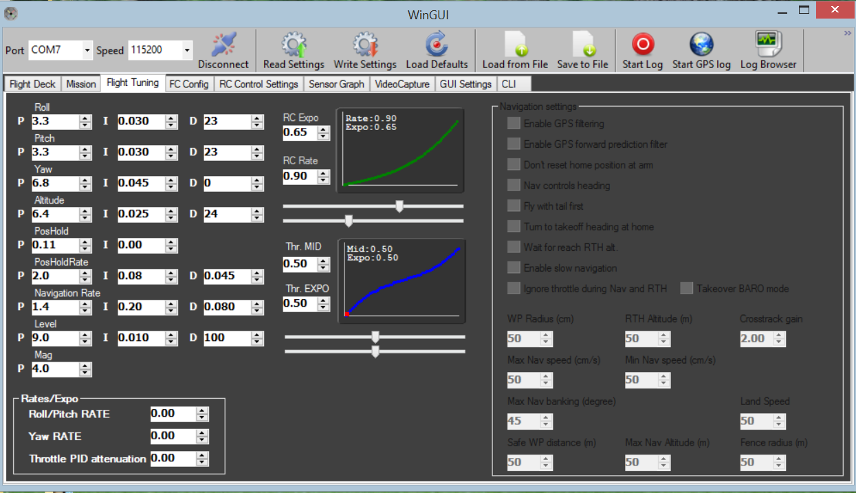

G+_Steve Prior Posted August 30, 2015 Share Posted August 30, 2015 Fr. Robert Ballecer, SJ In KH episode 138 you covered tuning PID. My KH250 build seems petty stable when flying level, but when I'm descending from high the quad wiggles and makes noises on the way down. From ep 138 that would imply that I should raise the I, but I just went to the WinGUI settings menu for the Flip 1.5 and there isn't just one I, there are lots of them - which should I start tweaking? Link to comment Share on other sites More sharing options...

G+_Steve Prior Posted September 7, 2015 Author Share Posted September 7, 2015 Not yet, but I need to spend more time trying. The drone scares people when it descends by making noises like it's coming in for a crash. Link to comment Share on other sites More sharing options...

G+_Steve Prior Posted September 9, 2015 Author Share Posted September 9, 2015 I don't think it's the props, even with CF prpps out wobbles on the way down, but I'd fine when going up. Link to comment Share on other sites More sharing options...
