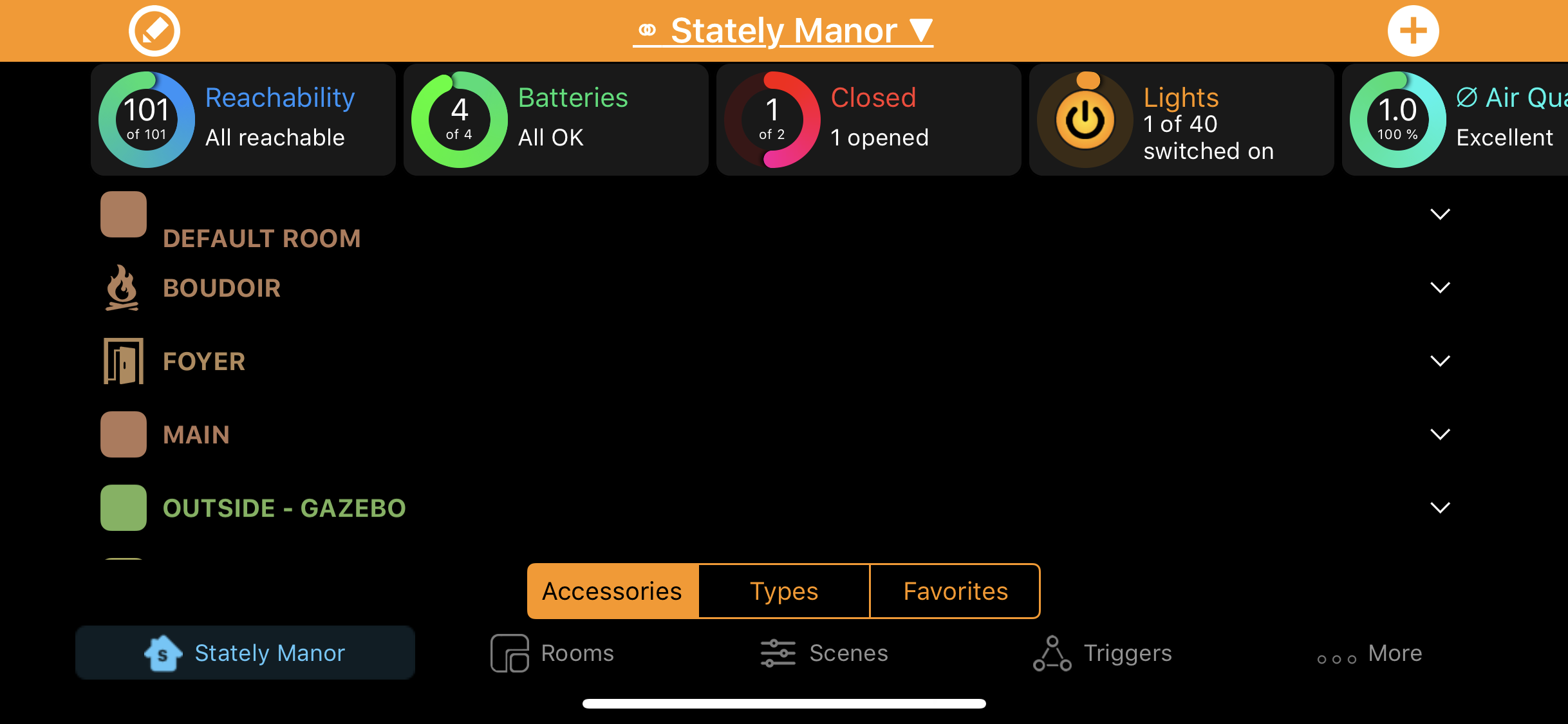

G+_Robert Hafer Posted July 19, 2018 Share Posted July 19, 2018 Passed a milestone for my HomeKit controlled home. Link to comment Share on other sites More sharing options...
G+_David Peach Posted July 19, 2018 Share Posted July 19, 2018 And the milestone is that you have almost all the lights off at once? You must have teenagers if that rarely happens. Link to comment Share on other sites More sharing options...
G+_Paul Hutchinson Posted July 19, 2018 Share Posted July 19, 2018 My guess is that the milestone is > 100 devices connected. Link to comment Share on other sites More sharing options...
G+_Robert Hafer Posted July 19, 2018 Author Share Posted July 19, 2018 Paul Hutchinson Yes all connected and reachable at the same time Link to comment Share on other sites More sharing options...
G+_Rud Dog Posted July 19, 2018 Share Posted July 19, 2018 Robert Hafer as a novice would like more info as to what this is also what software and hardware is in use. Thank you. Link to comment Share on other sites More sharing options...
G+_Robert Hafer Posted July 19, 2018 Author Share Posted July 19, 2018 Rud Dog sure. (Warning: asking old time Home Automation nerds about their setup can lead to Verbosity) The screenshot is from the myHome app (myHome-app.com) on my iPhone. It has these status displays plus it’ll set up HomeKit Zones which the Home app won’t. The brains of my smart home is Indigo (indigodomotics.com) running on a Mac Mini. Plugged in are an Insteon 2314u controller and an Aeotec Z-stick for Z-wave. There are plug-ins for Indigo that let me spoof Insteon and Z-wave devices as HomeKit or Echo-Friendly devices. Most of my light switches are Insteon, most of my sensors are Z-wave. I have a Nest thermostat but my life proved to chaotic for its learning capacity so I control it with Python scripts and sensor data in Indigo. Of course there’s WiFi. Some iDevice switches, Lifx smartbulbs and Koogeek powerstrip are HomeKit native devices over WiFi. Elgato sensors communicate via Bluetooth so I find they work best near an Apple TV which also lets me communicate with HomeKit when I’m net home. I started with Home Automation in the 80s with X10 and I still have one active X10 Switch (because it’s hard to get to). Mostly it’s an added to situation rather than replace. Insteon probably has the best variety of products (a smaller number are compatible with non-US wiring). Both Insteon and Z-wave are paired to a local controller and are very secure once paired. How you make them visible outside your network is up to you. Whereas, the modern generation of IoT devices often have to talk to the cloud to function. Using HomeKit means I’m relying on Apple for network security. I find that you need some kind of central brain if you’re going to use multiple protocols. I can ask Alexa to turn on a light and Siri to turn it off and everything stays in sync because it all goes through Indigo. Well, I’ve rambled on enough they’re starting to wonder what I’m doing at work. If anyone has questions, please post; beats working. indigodomo.com - The Indigo Smart Home System for Mac OS X Link to comment Share on other sites More sharing options...
