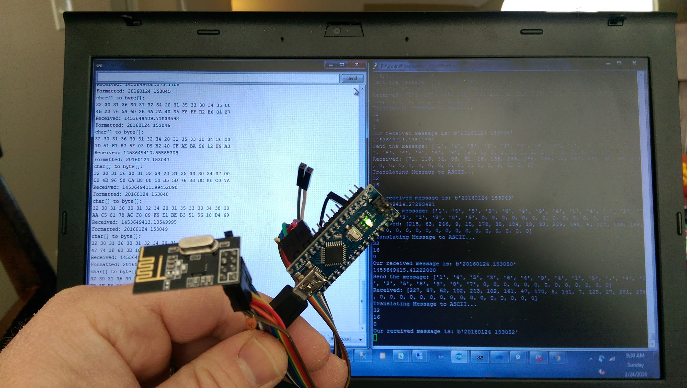

G+_Ben Reese Posted January 26, 2016 Share Posted January 26, 2016 I got some Amazon money for Christmas, so I got an Arduino Nano and a few NRF24L01+ radios. After watching several YouTube video and reading sample code, I got the Arduino to talk to my Raspberry Pi. I've seen these radios used a lot for IoT stuff, but I've also seen a couple demonstrations of wireless packet sniffing. If someone can read the signal wirelessly, he can replay that same message. So, I want this encrypted. I found an AES library that works very nicely on the Arduino and can now send encrypted messages between the two devices. But because I want this to be secure, I have some concerns and questions. 1) How important is it to keep the AES Initialization Vector private? Isn't keeping the IV single-use more important than it's randomness? 2) I think I've seen programming of Atmega chips programmed through the the SPI bus - the same connection as the 2.4GHz radio. Would it be possible for a bad actor to to reprogram the Arduino over the wireless chip? Overall, this has been a very fun project and I've learned a lot about AES encryption! Link to comment Share on other sites More sharing options...
G+_610GARAGE Posted January 26, 2016 Share Posted January 26, 2016 In order for the arduino(or any embedded device) to be reprogrammed, it needs to be in the boot loader to be reprogrammed. So I wouldn't worry about that. Link to comment Share on other sites More sharing options...
