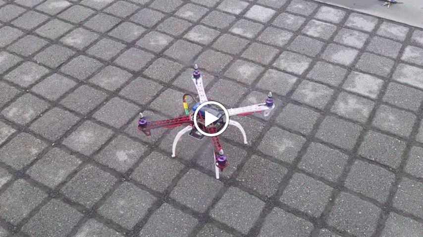

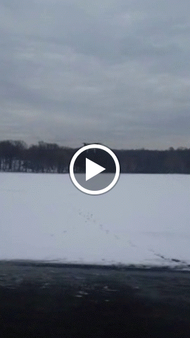

G+_Claude Gregoire Posted March 21, 2015 Share Posted March 21, 2015 BAD NEWS!!!!!!! On my first flight this happened. The power just cut out and then came back on for a second just before it crashed. I am using the FlySky T6 radio. Do you guys think that this was the reason? It might have also been an issue with one of the motors which was damaged during a crash. I am prepared to rebuild it but I am wondering if I need to also upgrade my radio. I am thinking about getting Futaba 6J. Link to comment Share on other sites More sharing options...
G+_Fr. Robert Ballecer, SJ Posted March 21, 2015 Share Posted March 21, 2015 I see the problem... Your antenna wire is threaded through the frame of the craft. That frame is an AIO frame/power distribution board. (i.e. it's got metal traces all through it.) The antenna cannot touch ANY surface that has metal. If it does, you will attenuate the signal, which causes the T6 receiver to shut down the motors. (Safety precaution... to prevent flyaways) Watch the coming episode of "KH" to see a good way to secure your antenna. -- Basically, I use a zip tie and some fasteners to hold the antenna away from the body in the proper orientation. Link to comment Share on other sites More sharing options...

G+_Claude Gregoire Posted March 22, 2015 Author Share Posted March 22, 2015 Well all 4 motors are still spinning the problem is that the pin on the top is bent on two of them. I definitely am getting the EMAX this time. I have watched my crash video a ton of times and I am starting to wonder more and more if the power cut off was a range issue. The reason I am thinking this is because I have been running it at home and putting the antenna to the frame and I can't make it cut out like you suggested may have been the problem. Does it look like a short enough distance that it should not have cut off? There was a beep just as it cuts out. I also just finished watching episode 116 Quadcopter #2 about 11 minutes in where you say that you have a homing procedure on your Flysky that if it loses signal that it will back up till it requires a signal. I could not find this in the settings. If this is so could you please explain it? Thanks again for the feed back Claude Link to comment Share on other sites More sharing options...
G+_Fr. Robert Ballecer, SJ Posted March 22, 2015 Share Posted March 22, 2015 FlySky does NOT have that failsafe. It only has "shut off" when it goes out of range. My Futaba J6 has a failsafe that allows the craft to turn itself to the left in lazy circles until it requires signal. Link to comment Share on other sites More sharing options...
