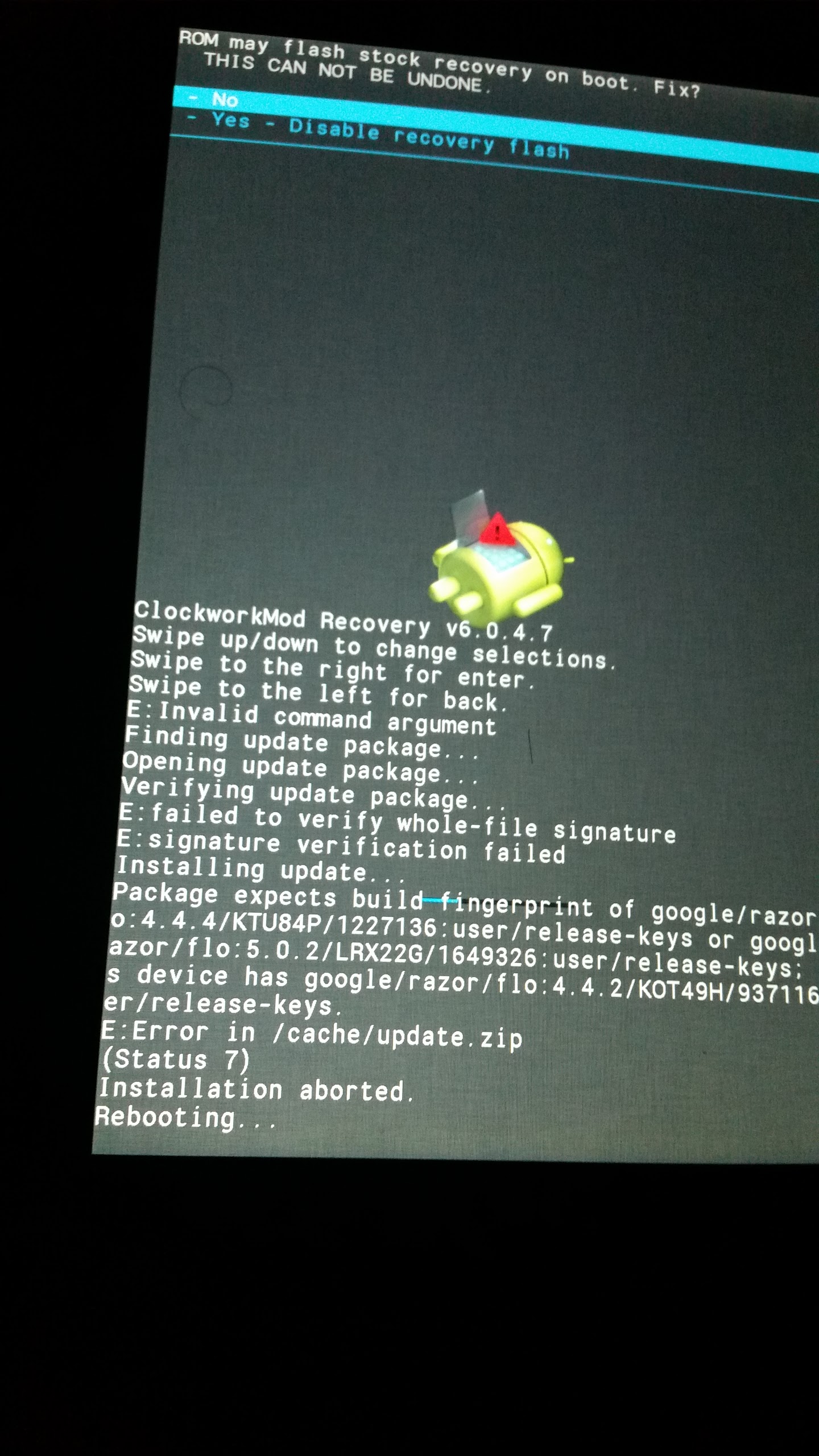

G+_John Lynch Posted February 21, 2015 Share Posted February 21, 2015 I have a nexus 7 2013 and rooted it with towleroot and now it won't upgrade to lollipop. Can't anyone help me Link to comment Share on other sites More sharing options...
G+_André Weigel Posted February 21, 2015 Share Posted February 21, 2015 I had the same problem. Since some root programs write to the system and the lollipop Updater checks that, you will need to reset the device to the original stock rom. You'll find the procedure on Google. You need to unlock the Bootloader which will clear all your files, so Backup everything you need. Link to comment Share on other sites More sharing options...
G+_WalkwithDante J Posted February 21, 2015 Share Posted February 21, 2015 Check out XDA to see if there is a odin(i think thats a samsung thing) you can use to flash a stock rom. I hope you have a backup stored somewhere. Link to comment Share on other sites More sharing options...
G+_André Weigel Posted February 21, 2015 Share Posted February 21, 2015 https://developers.google.com/android/nexus/images Odin gibt es hier leider nicht. Aber die Fastboot Prozedur ist nicht schwierig. Einfach mal reinlesen und das Update File der Einfachheit halber umbenennen, damit du in der Konsole nicht soviel tippen musst Link to comment Share on other sites More sharing options...
G+_André Weigel Posted February 21, 2015 Share Posted February 21, 2015 Sorry. Forgot to write in English. Use Fastboot instead of Odin since Odin is not available for the nexus brand. Rename the update file to save some letters in the console Link to comment Share on other sites More sharing options...
G+_jay red Posted February 22, 2015 Share Posted February 22, 2015 Try wug fresh toolkit Link to comment Share on other sites More sharing options...
G+_TJ Evans Posted February 22, 2015 Share Posted February 22, 2015 Just flash the Straight from Google Lollypop and re-root ... ?(remove the -w to not wipe!) Link to comment Share on other sites More sharing options...
G+_Scott Abramczyk Posted February 22, 2015 Share Posted February 22, 2015 Wugfresh , once its set up, its 1 click? Link to comment Share on other sites More sharing options...
G+_Wayne Gomez Posted February 23, 2015 Share Posted February 23, 2015 I have a mac, anyway I can get this done a mac? Link to comment Share on other sites More sharing options...
G+_André Weigel Posted February 23, 2015 Share Posted February 23, 2015 Emulating a windows or Linux computer should help either way ? Link to comment Share on other sites More sharing options...
